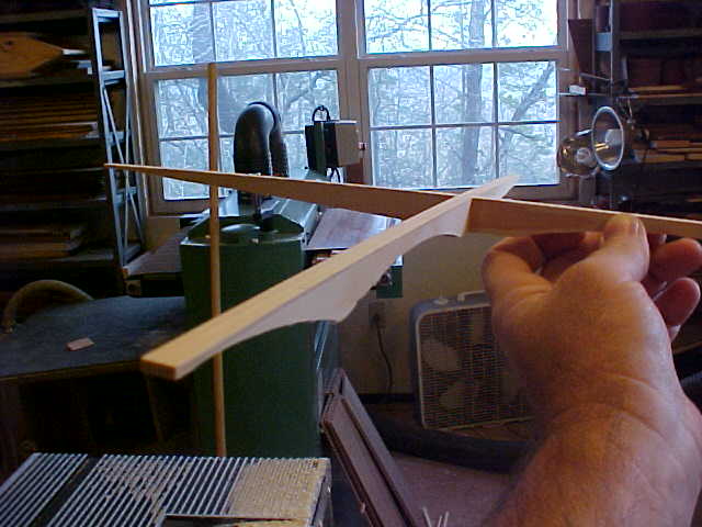

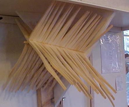

Check your email, I responded to your address stored in my computer, not the private messenger. Matter of fact, to show how well it worked recently for me I put up two shots of the out-working, here they are again.
